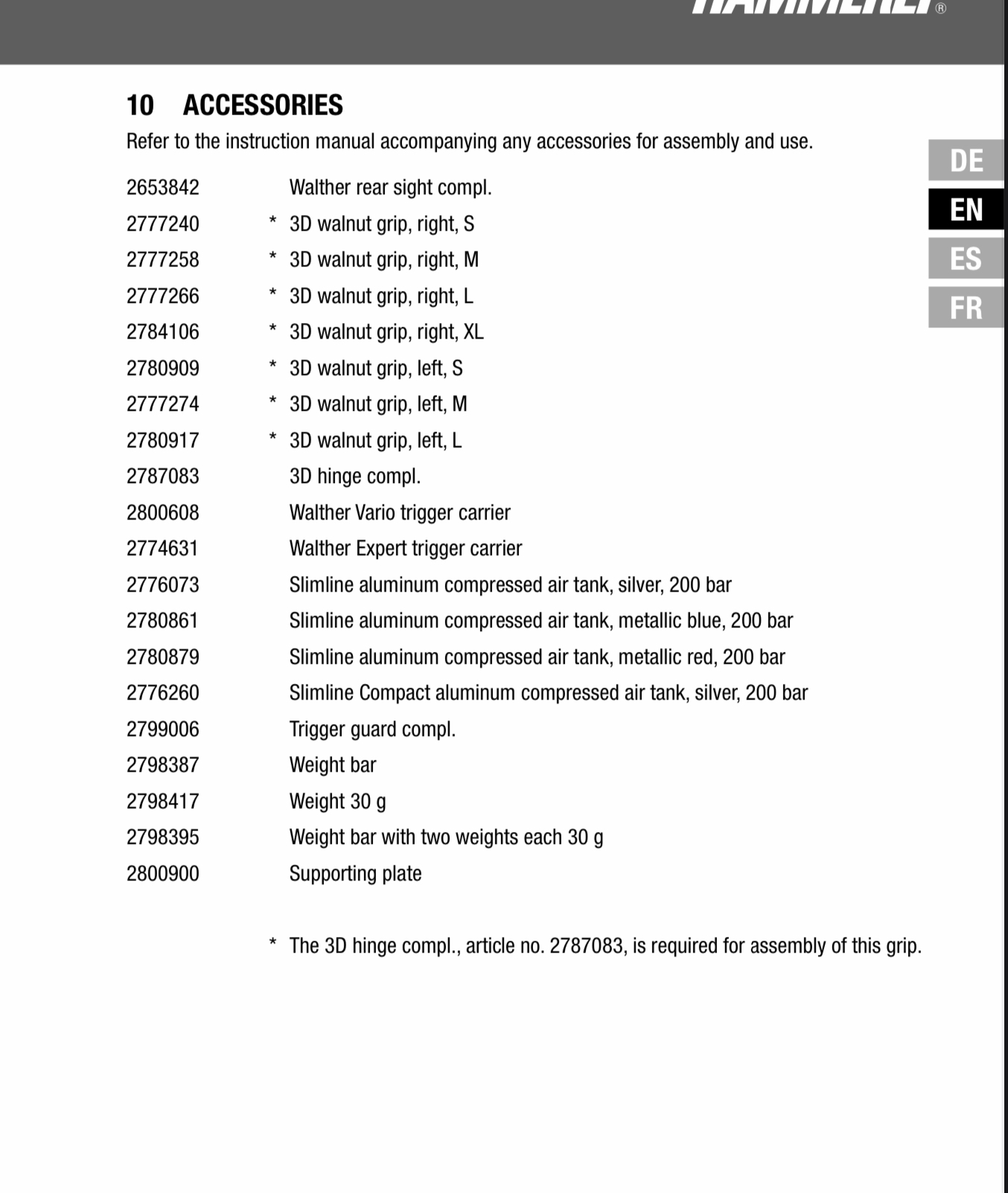

They are listed as an accessory for the Hammerli AP20 pistols, on the Walther website. Also, in section 10 of the manual.
https://www.carl-walther.com/sport/products/p/2798000
We are also using several of the AP20’s.
