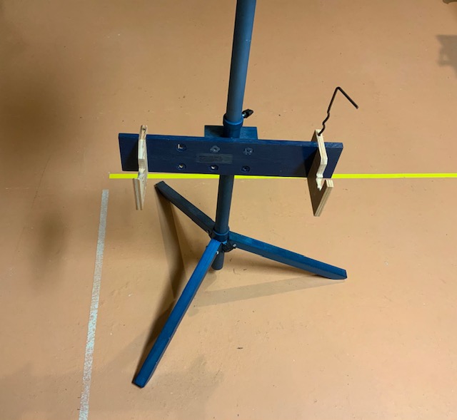

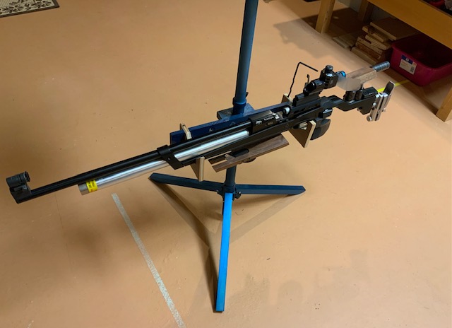

About 20 years ago I introduced my wife to 3p small bore. She refused to place her rifle on the ground. I looked everywhere for a rifle rest the I could attach to her stand. I found nothing so we created our own. I made about 30 of them. All the shooters at the club used then. A couple on college teams bought them as well.
It never caught on. You can find a version made of metal online. Mine is made of wood.. I still use mine everyday. I now shoot air in my basement.
I love it. It makes it easy to put your rifle down and pick it up with no effort.
If you want to know more let me know.

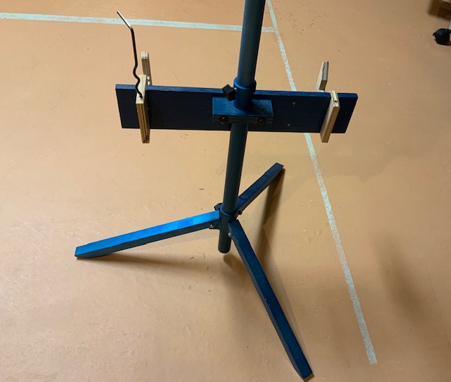

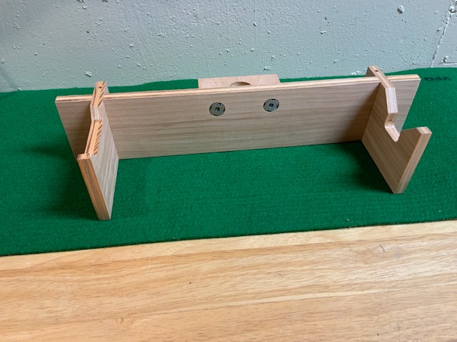

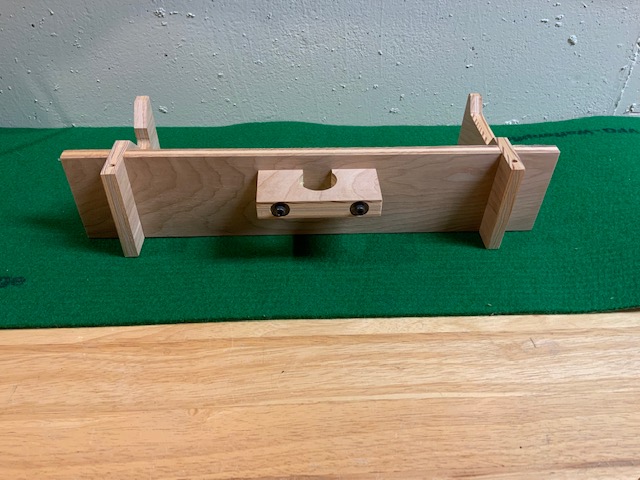

Here are some pictures of the one I built and use. If it meets your needs I still have the materials to build you one. I would ask you to cover shipping.

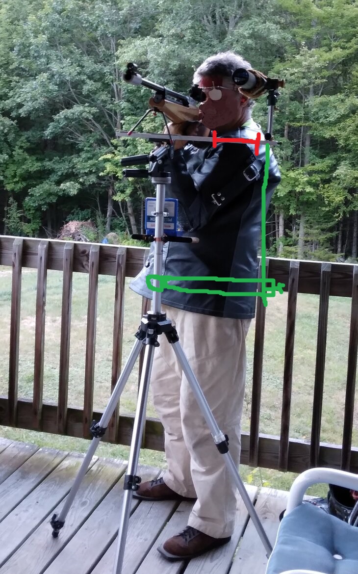

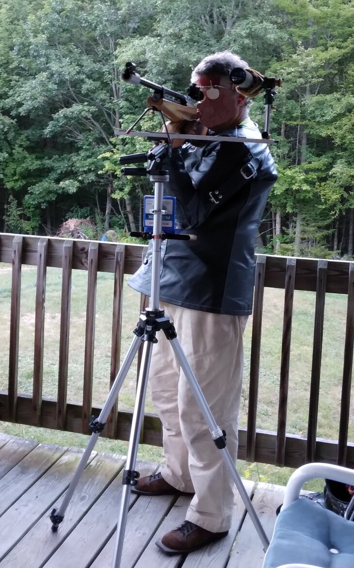

"no part of the stand is higher than the athlete’s shoulders when in the standing position."
Key words here are "When in the standing position", I drop my leading shoulder a bit when in position, states "shoulders" plural, so that no part of the stand is higher than the lower shoulder Or higher than the higher shoulder?
Re reading this, shoulders (plural) meaning both, so the stand needs to be higher than both shoulders to be not proper.
Also questioning, is the spotting scope "part" of the stand?
One possible is that the scope is attached to the stand so it is part of the stand.
Another take would be , the scope is not being used as a part of any support, so it is irrelevant...?
How about, cut the top rest rectangle(red), then mount the spotting scope on a lower portion of the stand? Easily done with an aluminum rectangle and another vertical rod.
Or , first picture, the area where the spotting scope is mounted scope is not being used as a rest, so that area is irrelevant. ...?
