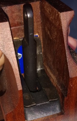

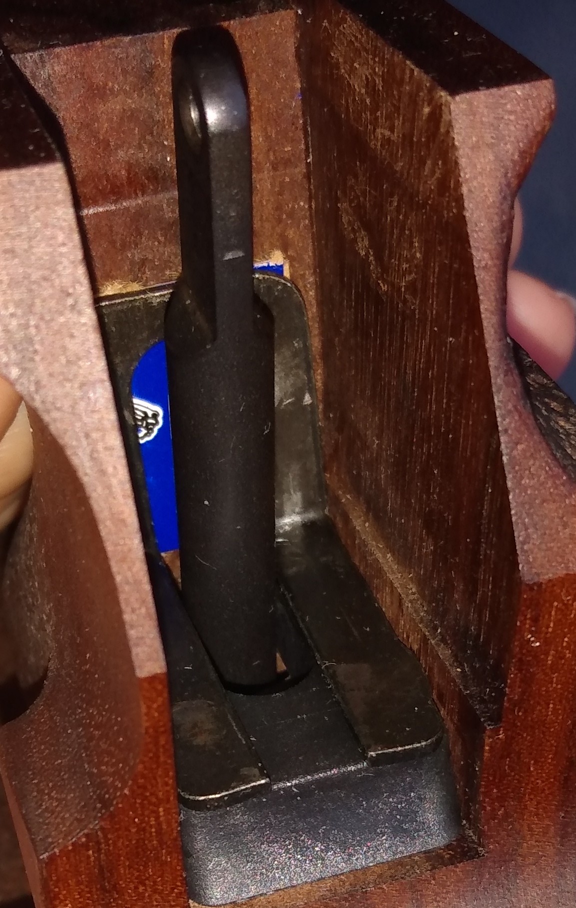

Does the grip rod freely move down in the slot? Sometimes the wood shrinks and causes the L shaped sheet metal spacer to spring closed by a small amount when the rod is extracted.

Here is the example of the problem I had. Does your grip strut rod easily clear the spacer plate? This one is rubbing, and prior to that would not go in. I had to lightly file it. It should drop in without interference.
