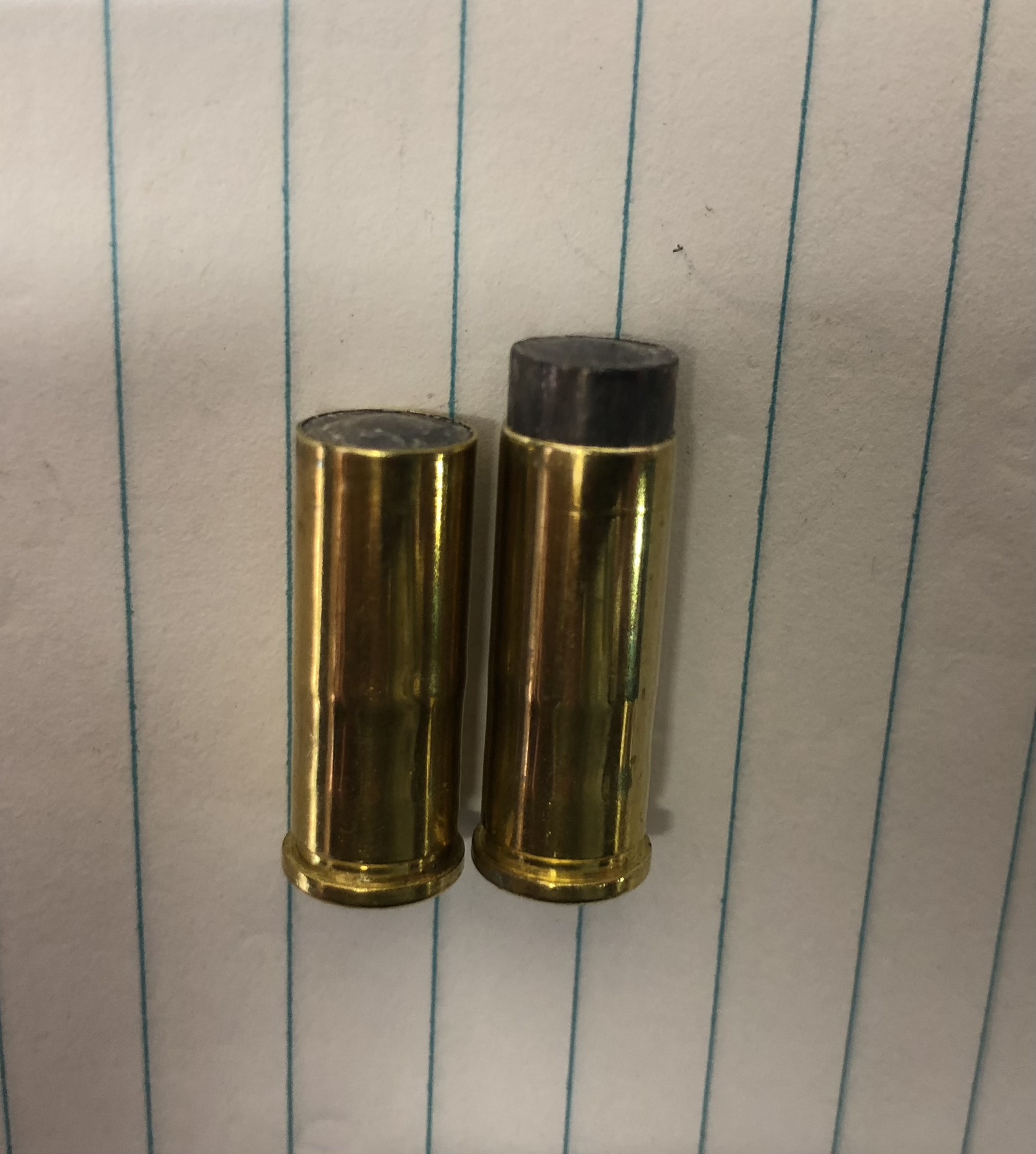

So, I started reloading in earnest. The first round to pass through the crimping die at station 4 was a surprise (see photo). The round, after seating the pill in station 3, is on the left and the round, after resizing and crimping, is on the right. I could not figure out what on earth was going on. It then dawned on me that the resizing, which occurs as the round enters the FCD was creating air pressure which was “jacking” the pill upwards. I tested this hypothesis by putting through some rounds without primers (or powder) so pressure could not build up. The pills stayed flush with the case mouth.
The crimp on the pills looked no different than my Dillon roll crimp die gives me. So, needless to say, the FCD was promptly removed and the Dillon crimp die reinstalled.
