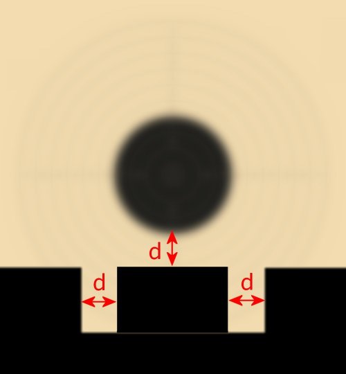

Having proper glasses can help keep your focus on the front sight. Depending on you current visual setup (good eyes?, contact lenses?, glasses?), there are a number of options. Basically, you want to add +0.75 Diopters of correction to your shooting eye to bring your relaxed focus closer to the front sight. That makes it easier to stay focused on the sight, and much harder to look at the target.
The recommended sight picture looks like this:
Air-Pistol Target w Sights w Arrows (sm).jpg (13.7 KiB) Viewed 16368 times
The space between the bottom of the black should be roughly equal to the gaps on the sides of the front sight.

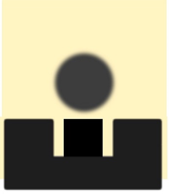

Only one minor change to the sight picture, because your eye likes to see symmetrical things,
make the foresight appear as a square.
Here is a sub 6 o'clock hold sight picture with a square foresight,
1 1/2 to 1 ratio rear sight to foresight and at 70% width of target black.
sight 70%.jpg (11.26 KiB) Viewed 16151 times

Posts: 1719
Re: 10m air pistol
Try this, without my rear sight and when my eye wants to see a square.
Sight Square.jpg (22.78 KiB) Viewed 16036 times

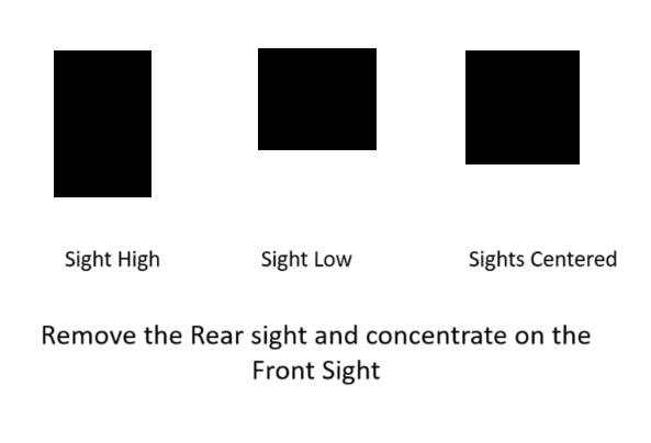

Posts: 1719
Re: 10m air pistol
With the front sight set up as a square when in the aligned position and the focus is sharp, then you don't really need the rear sight.
If you see a vertical rectangle then the gun is pointing HIGH.
If you see a squashed square the gun is pointing LOW.
If your eye sees a square the sight are in line.
The subconscious will find the square very easy, even with the rear sight blurred.
Helps make the shooting easier.
