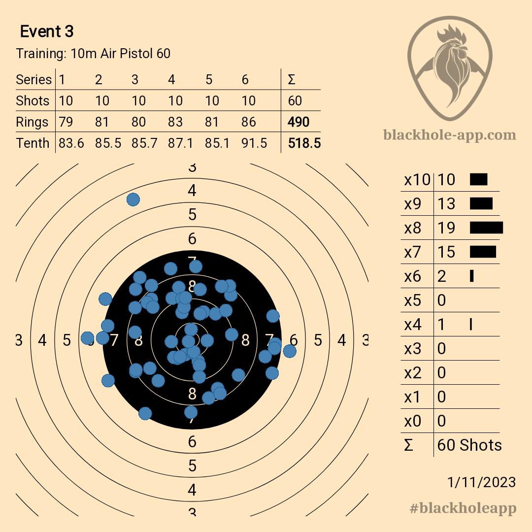

So far I've shot on 5 evenings, and 3 of those were matches. So far scored 459, 466 and 490 in the past 3 weeks with the 10m air pistol. I've also been doing some of the shooting exercises and games on the electronic targets
Unfortunately I can't own a pistol for the next 6 months, so I can't practice at home, and I can only shoot once a week during this time.
What are some realistic goals / objectives for the first 6 months and for the first year? should I be striving for a particular score/grade in the 10m air pistol, or just try to continually improve? Are there any training plans I should be following when I'm at the range?
Anyway, this was my effort last night using a club Hammerli AP20

4- Don't set a number as a target. First, try to keep all 60 shots in the black. Then eliminate the 7's, and so on.

From your attitude and your first scores and the 60 shot you have posted I know you will do well and quite quickly too.
