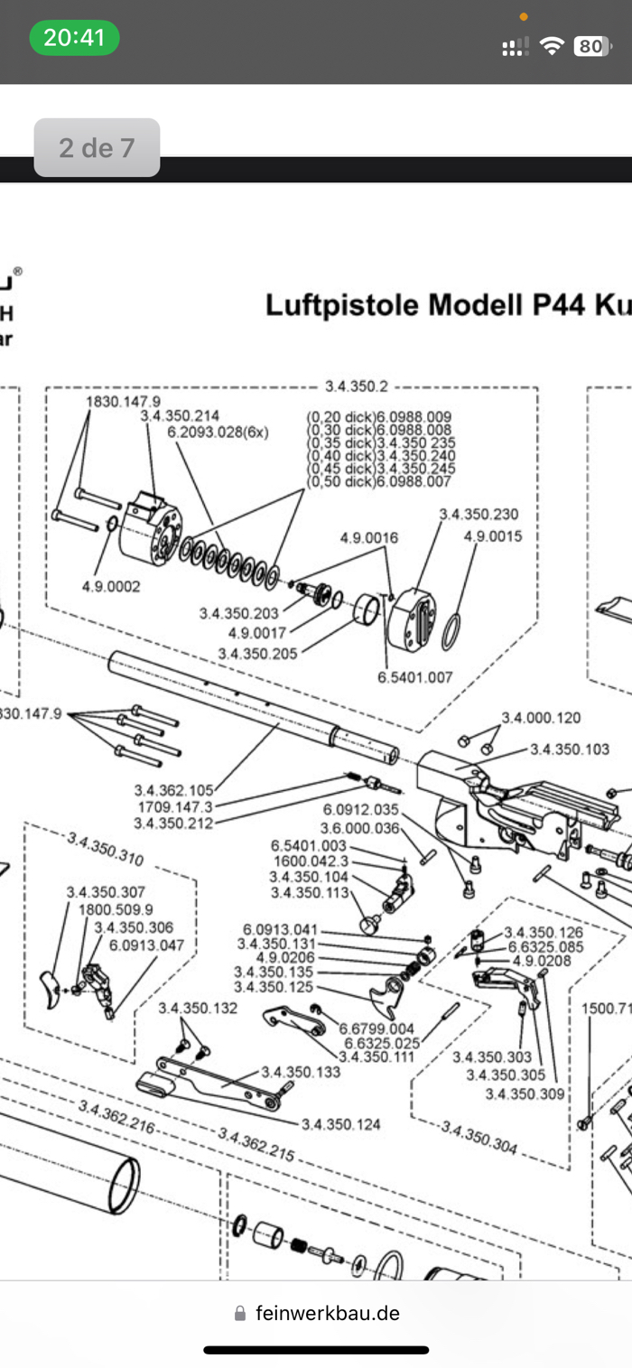

How much should I screw the cylinder! Until he doesn't go anymore and gets tight? It's an FWB P44?
And what parts is from the pressure reducer seals?
I choose to know the Price of this ones:
4.9.0002
6.2093.028(6x)
4.9.0015
4.9.0016
4.9.0017
0,20 dick)6.0988.009
0,30 dick 6.0988.008
0,35 dick)3.4.350 235
0,40 dick) 3.4.350.240
0,45 dick)3.4.350.245
0,50 dick) 6.0988.007
Thank you

Screwing on the tank only opens the tank valve, so firmness has no part in pressure.
Screw the tank in to be hand firm only, the O rings do the sealing. This allows high pressure
into the pressure regulator and pre-charge chamber.
The pistol pressure is controlled by the spring pile in the pressure regulator, adjustable
only by gunsmith/factory (changing pile).
Pellet velocity is controlled by spring hammer strike on poppet valve.

Agree with David - not too tight. Also the aluminum threads can gall, so I like to lube the threads (only) with a thin film of silicone grease
