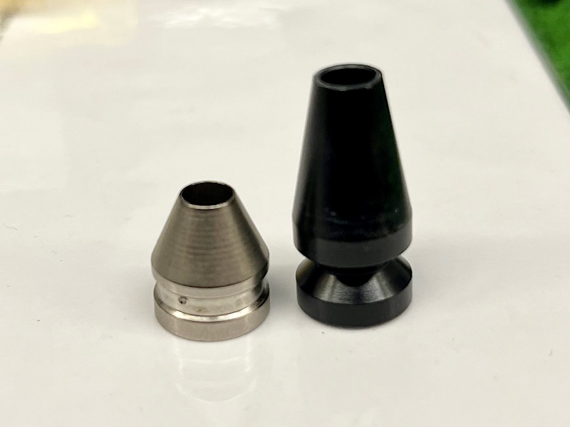

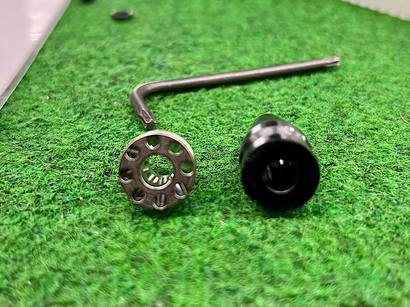

The Lp1 shroud is about 20mm longer than the Evo, the barrel isnt. Naturally, the old inferior ductless compensator is adapted to bridge this gap.
The Lp1 shroud is also missing the vents around the compensator compared to the Evo, instead sporting two ports located on each side of the sight post.
Here is a couple pictures showing the differances between the two comps:

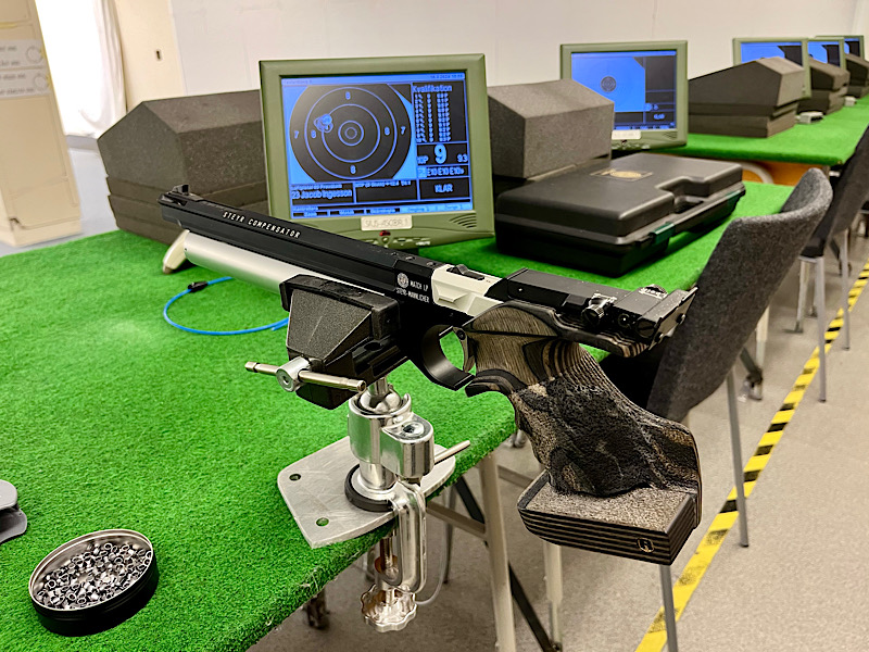

My range doesnt have a vice for testing, so I came prepared:
With my makeshift rig I got off a few strings of 10 shots to try it out, it provided a somewhat scattered group but after a couple strings it settled in and provided somewhat trustworthy groups, or at least groups looking like groups from, well, other makeshift test rigs from the past.

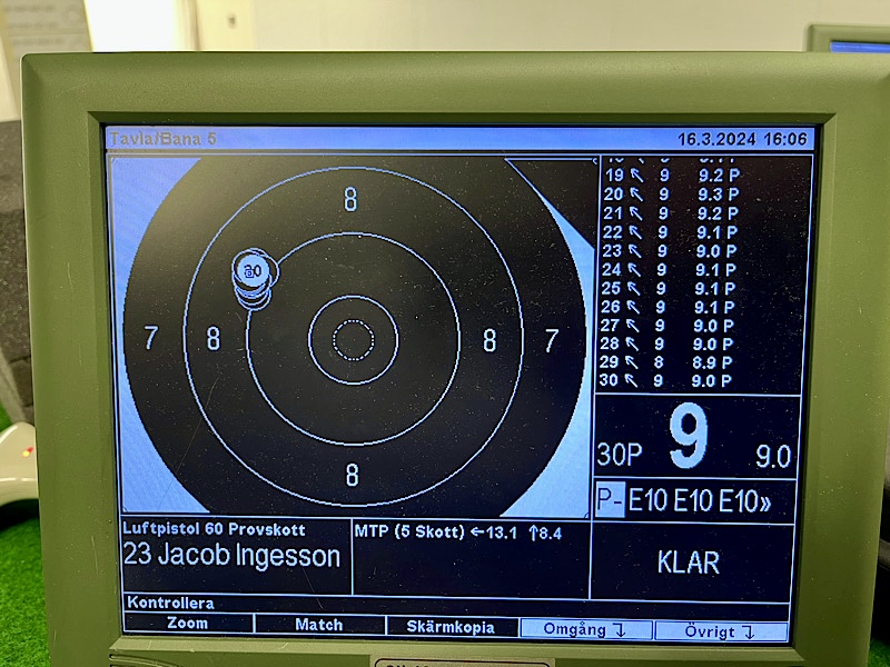

First sample string of 10 shots from the old inferior ductless comp:

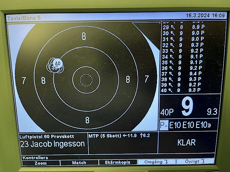

Dropped in the performance enhancing 8 duct comp fully expecting a terrible group due the reasons mentioned above.
Shot a throwaway 10 string to let the rig settle, got one flier but it started to group.
Did another sample 10 string that looked like this:
At least its not worse, if anything a tad but better. Given the stability of my rig, Id call it a draw.
