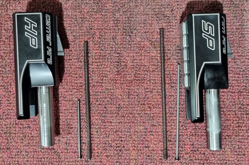

Hi, I have the Pardini HP, and it has been set up as 22 since I bought it.
I cannot for the life of me remember where the parts are for it, other than the 32 barrel.
My question is. When I change from 22 to 32 and vice versa, can I use the same guide rod and guide rod spring for either 22/32?

Yes, they are the same.

Thanks for that. What confused me is the different part number here on SP (716) and HP (816):

I check with the conversion here in France, .22 spring lenth is 130mm rod is 95 mm
.32 Spring 116 mm rod 56 mm ???

The recoil springs are different.
The 32 spring has larger diameter wire and is shorter than the 22 spring.

Pardini over stresses their springs. They will shorten by quite a few mm just from use. The only accurate way to compare them is to count the number of turns, and accurately measure the wire size. A caliper isn't really good enough for that. You need to use a micrometer, and support the inside with a snug fitting drill shank. Measure the drill diameter, and then the OD of the spring on the drill. Take the difference & divide by two to get the wire diameter.

The sizes (lenghts) i wrote comes on brand new springs for both.

Awesome, thanks. That makes sense because I did find the shorter guide rod. So that must be for the 32.Jeff-France wrote: ↑Wed Jul 17, 2024 11:10 am Hi,

Let me be more precise: I've been told by an armurer that they were the same. Maybe they are interchangeable ?

i got a Pardini SP with the HP conversion kit
the springs and the guide rods are definitely not the same. the HP spring is much stronger
