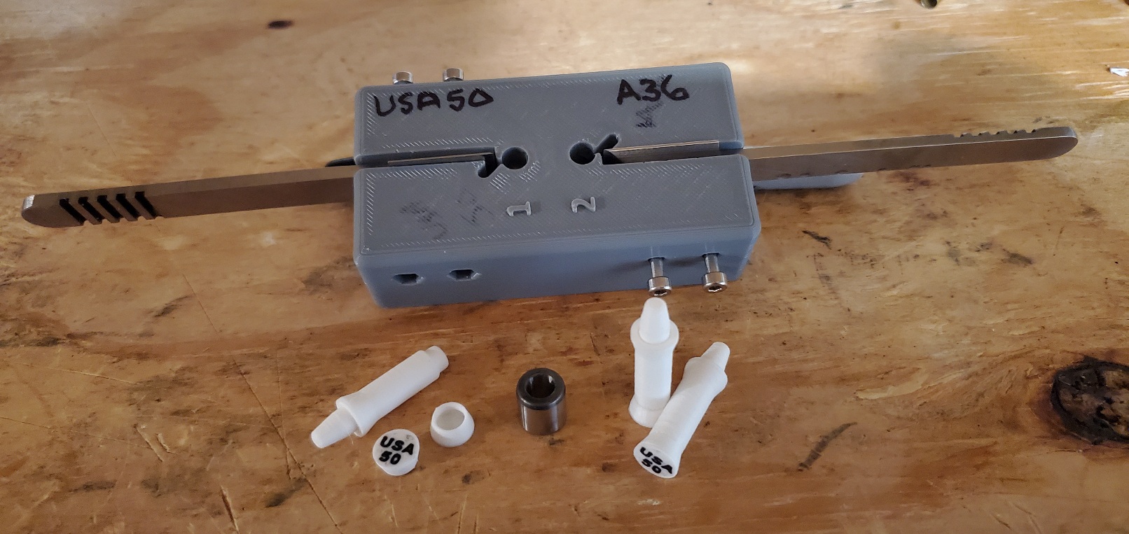

1845greyhounds
Posts: 102
Location: Fishers, Indiana
Re: 3-d printed scoring plugs?
Post by 1845greyhounds »
In my experience, FDM 3d printing alone is not accurate enough to make score plugs. I only have experience with FDM printing, but RESIN 3d printing MIGHT be accurate enough...

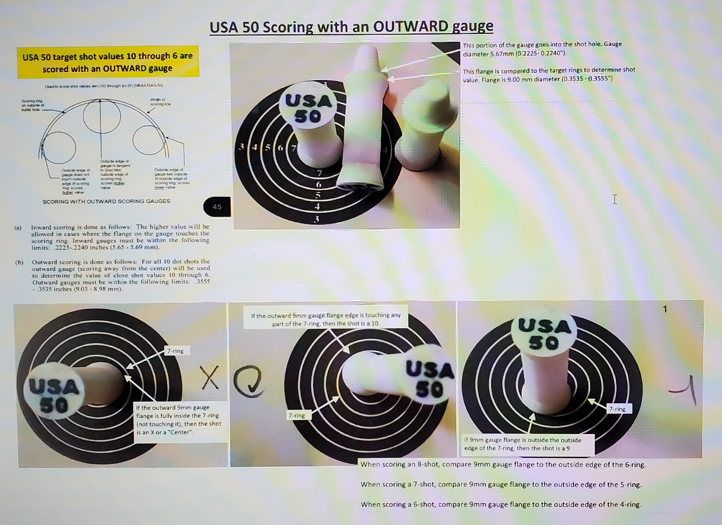

The USA50 score plugs I made and sold were FDM 3d printed a few thousands oversize and then formed/cut down to size using the following methods. The 0.2225 - 0.2240" plug section was thermo-formed by spinning a precision drill guide bushing over the printed PLA plastic plug. The friction created adequate heat to lightly melt the plastic and shape it into the correct size with very low TIR. Then I concentrically cut the 0.3535 - 0.3555" shoulder relative to the 0.223" plug surface with a 3d printed fixture that held a chisel blade. Finally, a "USA50" ID cap was glued onto the handle. The ID caps were printed with a smaller nozzle to produce legible text. For all printing steps, I'd print 64 at a time to maximize printing efficiency, while maintaining the ability to selectively abandon failed prints within my printer's controls.
